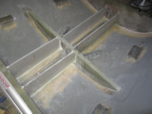

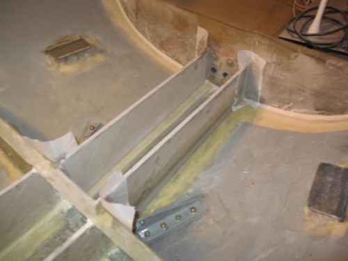

Brief Description:  Aft Tunnel #5
I layed up the lower joint of the walls first let that jell cure then did the forward and aft joint on both sides. As always I made sure to peel ply the layups. I took a dremmel and ate away some of the foam on the edges of the cargo floor. I mixed up a batch of QCell and epoxy and filled in the edges of the cargo floor. It came out well. :-)
