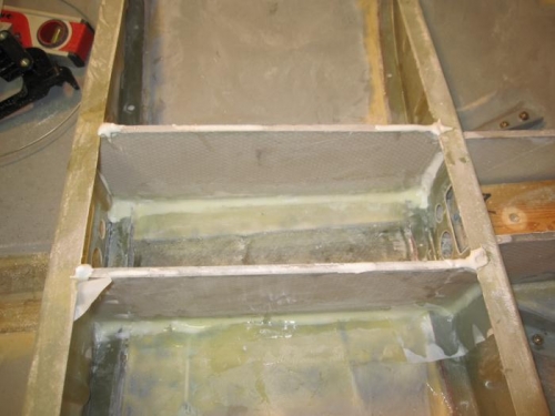

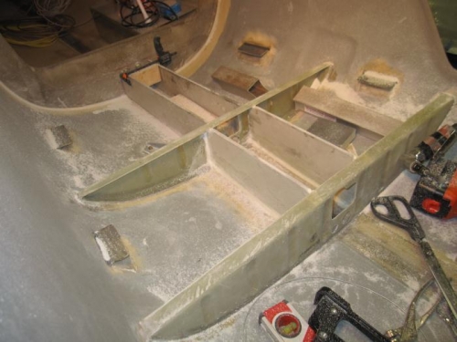

Brief Description:  Forward section of aft tunel

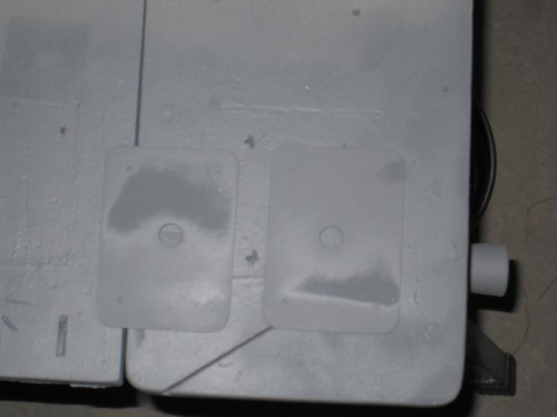

I cleaned up last nights epoxy work and cut glass and peel ply for the forward and aft ends of the tunnel walls. I sanded and cleaned up the ends for glass work. I whipped up a batch of epoxy and laid up the glass and peel ply. I also drilled the sump doublers and primed them for install.
