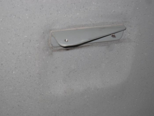

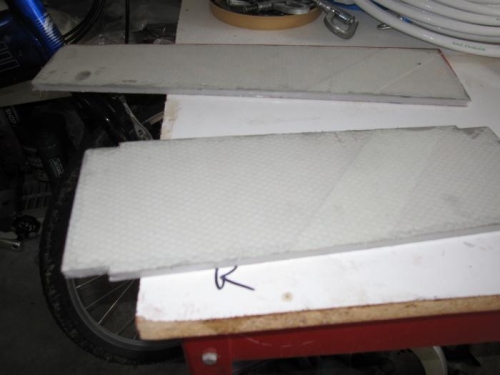

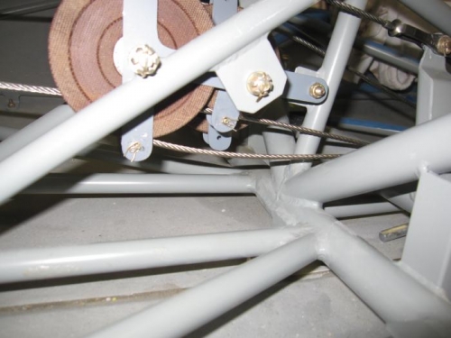

Brief Description:  Rear Tunnel #2
I finished the edges of the 2core2 material by using a dremel and trimmed some of the core along the edge. It was about an 1/8 in deep cut into the core, clean it up and fill it with some dry micro. I used the extra micro to bed the rear seatbelt attach brackets. I also installed the clevis pins for the forward pulley cluster for the cables I have installed. :-)
