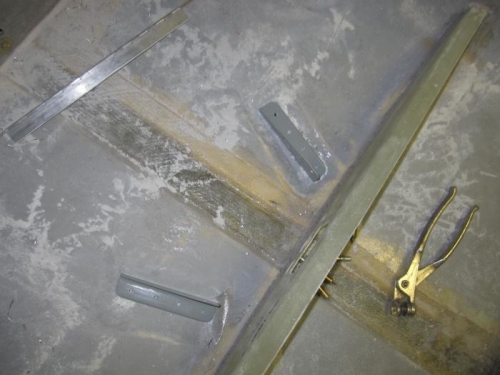

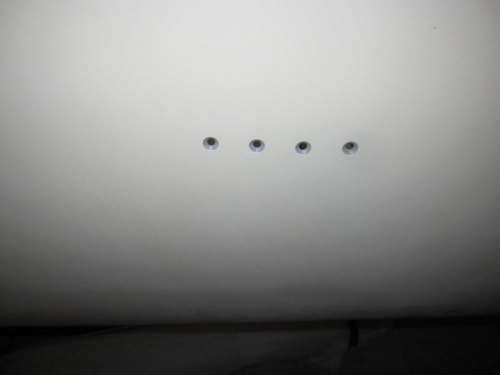

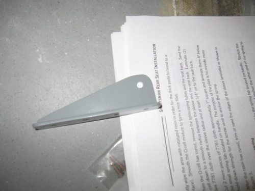

Tonight I installed the rear seat hardpoints. I lined them up and drilled to #10. Then removed them and drilled the 1/4 in hole for the seat belt bolt itself. I deburred them all and marked them, and I countersunk the outside for the flush screws that hold everything in place. Later I'll do the epoxy bed routine I did for the cage brackets.
