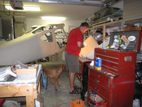

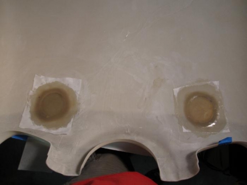

Brief Description:  Landing light holes
The kit cowling came with two holes for HID landing light and I purchased the wingtip landing light kit. So these hold have to be closed up. I had several ideas to fix it floating around in my head and strolled down to my new neighbor Matt's place. Matt is a fiberglass guy and pointed to the best way to attack this. I cut glass and peel ply and mixed up another batch of resin. I did the layups and peel ply with Ace my dog supervising.
