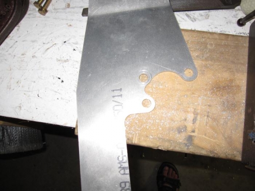

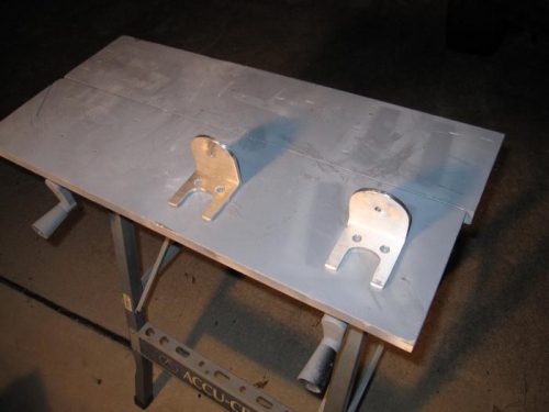

Brief Description:  Jack Points
I hacked at 2'x2'x3/16 angle to get the jack points together. The band saw could barly cut it. I fabricated two of them cleaned and deburred them. I also figured out how to build the wheel pants/ torque plate and brake flange and get them clear of the gear leg. Where the book had me place the brake flange I little clearance for the upper two bolts on the brake flange. I did tow things to help I used the manual tip of putting bolt heads on the inside and I removed one of the washers next to the spacer. Also don't forget to grind 3/16 off the lower spacer to allow for the jack point. Lots of work and learning on this opperation.
