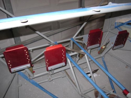

Brief Description:  Rudder Bumps
I fit and drilled the rudder pedal bumps. I used countersunk screws to secure them to the rudder pedals. This mod it is keep from draggin brakes which some do with the flat plate rudder pedals The other choice is to buy other pedals and make them work. I wanted to keep the anodized pedals and with the wing walk material it kept my paint scheme intact.
