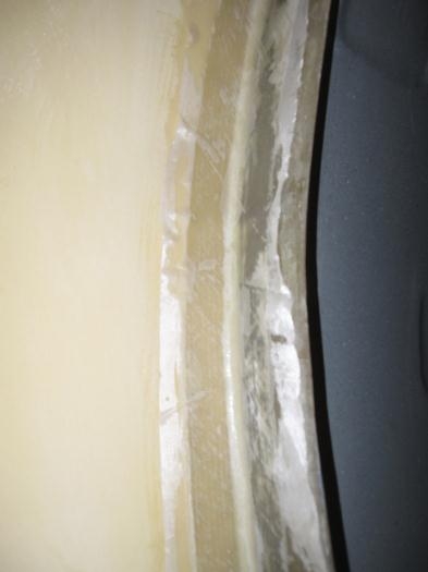

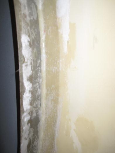

Bulkhead A #5
With the aft fillet complete I cut and wet out the BDM tape to secure the aft side of bulkhead A. I used peel ply over the layups and they turned out well. I have a copule of gaps in teh lower corners to complete tomorrow.
