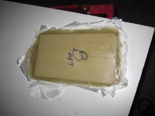

Brief Description:  Bulkhead A #4
Today is the last day for my batch of promoted VE resin so I have to use it up. To that I trimmed up a bit of foam and I am going to do a 2 ply glass layer on each side. I did a wet batch to seal the foam yesterday and let it cure then cut two layers of glass and peel ply. I laid up one side and then the other.
