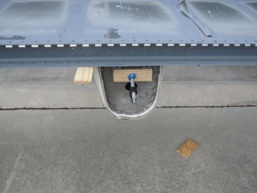

Brief Description:  Bulkhead E
Today I set bulkhead E. I bolted in the forward attach bracket and set the horizontal stab. I measured a 1.4 degree down angle of incidence and drilled a copuple of the holes to secure the stab. I secured the bulkhaed to the stab and laid a QCell fillet along the aft side of the bulkhead. I let that cure and sanded it. Later I set in the two layers of glass along the aft side of the bulkhead.
