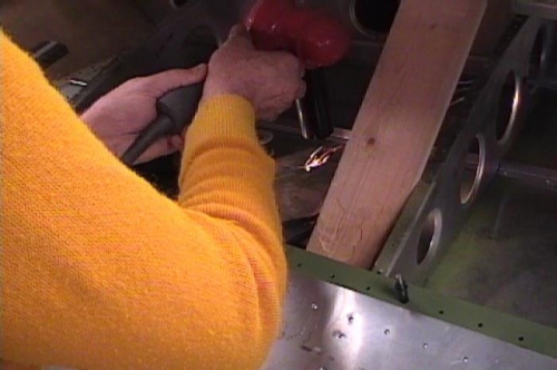

Brief Description:  Reconnected aileron trim cable
1, Inserted trim cable throught gromment in wing.
2. Stripped outer insulation back.
3. Stripped inner conductor insulation back, and tinned each wire.
4. Slipped large heat shrink tubing over entire cable on aileron side.
6. Slipped small insulation over inner conductors on aileron side.
7. Formed hooks in either end of conductors for splice.
8. One at a time, hooked like colors together, squeezed the hooks, and soldered.
9. Slipped tubing over each splice just made.
10. Heat shrinked small tubing in place.
11. Allowed assembly to cool, then slipped large heat shrink tubing over assembly.
12. Shurnk large tubing with heat gun.
13. Insured adequate service loop existed for cable between aileron and wing.
Shrinking tubing with hot air gun
