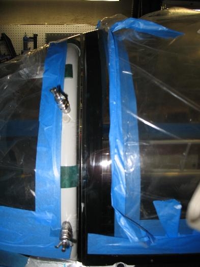

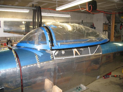

Brief Description:  Fit windscreen to roll bar

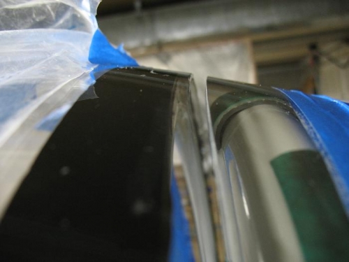

I did the final fitting of the windscreen. I wanted this done so I can put it away until it is time to install the top skin for good and do the fiberglass bezel around the edges. My fit was off since I re-cut the canopy side of things, I had to trim a little off the windscreen side. The space between the windscreen and the canopy section is not consistent at all but the windscreen edge will be hidden under the fiberglass bezel. I drilled and clecoe along the roll bar in 4 places. I plan to also glue on the windscreen with Sika Flex. I am using draw clecoes. With a compressible spacer and can adjust the tension of the draw clecoes so the shape of the windscreen matches the canopy perfectly. It is nearly perfect as is but I had a couple of spots where one side was slightly higher than the other. I am happy with the results but I know I could do better if I tried this a second time, but the heck with that I want to get flying.
