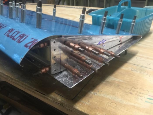

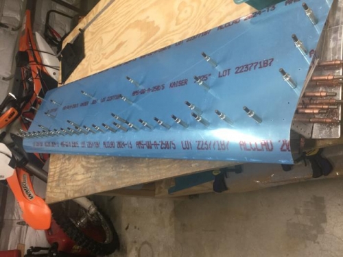

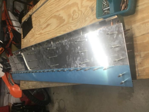

Worked on getting the Right Flap caught up. No major issues. Did a better job getting the inboard reinforcement plate bent to match the contours. It seemed that the bend wasn't quite square. It needed to be a little off square to align with the angle. The Angle was drilled with the edge right on the edge of the Spar. The 3 drilled holes in the Angle are extremely close to the curved radius. Reviewing the drawing, shows this is by design. Need to work through how to rivet those in because of the lack of space.
