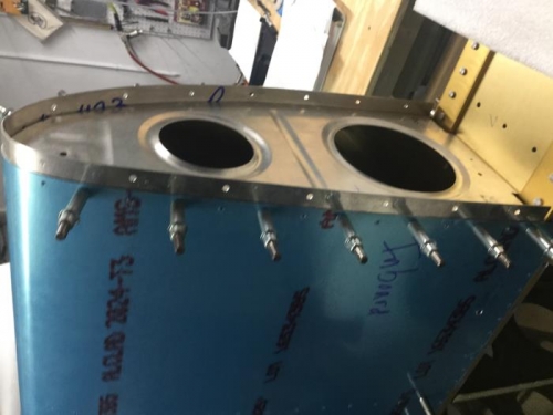

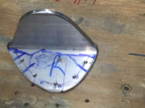

Continued Right Fuel Tank
Drilled holes in T-405 angle. Match drilled Tank Skin to W-423 plate. Then opened up both to #19 for nutplates.
Disassembled Right Fuel Tank to get ready for dimpling and final prep before Proseal time!
Match drilled to W-423 and opened to #19
Predrilled T-405
Disassembled fuel tank
