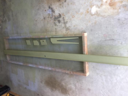

Cleaned and primed the four doublers and Rear Spar for the Left Wing.

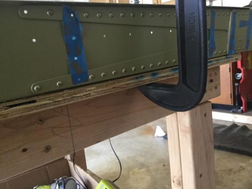

Installed these parts on the Left Wing leaving holes open for future parts. Only one 470 rivet needed to be drilled out and redone. It was not sitting flush on the Fork. The drill out tool for the 470's works great.

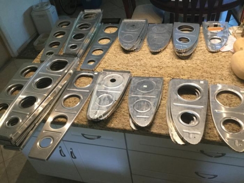

Sorted all the ribs for both wings. Labeled them and moved to the garage in prep for the FUN to come prepping and priming.....
Left Rear Spar Parts Primed
Left Rear Spar Assembled
Sorted All Wing Ribs
