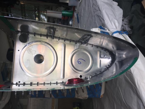

Pro-Sealed and 100% Clecoed Ribs 2-6 in the Left Fuel Tank. Added a little Proseal to the nose of the internal ribs to save on chaffing of the Rib Flanges on the leading edge of the Skin.

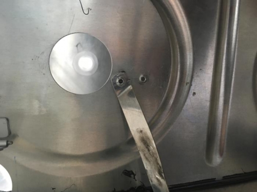

Match drilled and dimpled the Anti-Hangup Bar to Rib 2.

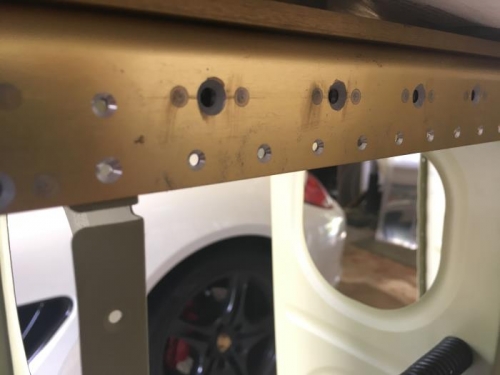

Started countersinking the Main Spar for the Main Skin Dimples.

Left Ribs 2-6 Prosealed/Clecoed
Anti-Hangup Drilled/Dimpled
Countersinks on Main Spar
