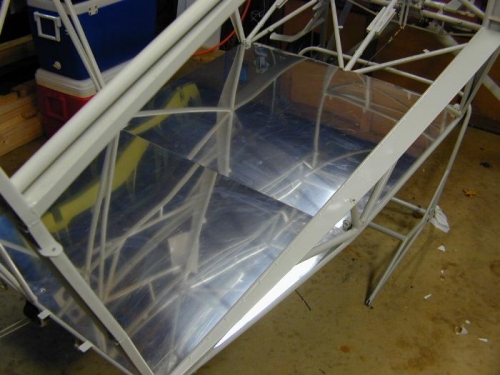

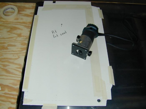

Brief Description:  Floorboards
I considered several ways of cutting the sheet aluminum and decided to go with the router. The router is fast and leaves just a bit of feathering on the edge but it cleans off easily with just a couple of light strokes of a file. Pictured is the baggage and rear seat floor.
