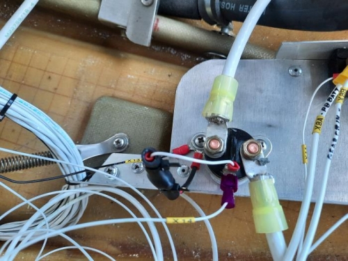

-realized that I had never installed a small diode on the starter solenoid as required by the ignition switch manufacturer and then installed it

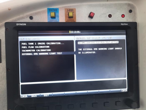

-figured out using the Dynon manual and the on-screen menus how to get the EMS red warning light to display above the right corner of the display
-went through the Power Buss installation and start-up manual and successfully got an annunciation of "Test OK" when pushing the red square light/switch above the Dynon display

Starter solenoid diode
EFIS EMS red warning light
