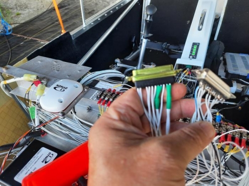

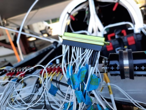

Well, finally I wrestled the beast to the ground and put it out of its (mine) misery... over 9 separate working sessions I managed to replace the soldered D-sub connectors with ones with crimped pins. This included J3 (warning lights), J4 (centre panel avionics), J5 (copilot panel), and J7 (centre panel switches). And it worked. Whichever soldered pins had been cross-connected or grounded, or whatever fault they had, the problem(s) disappeared.

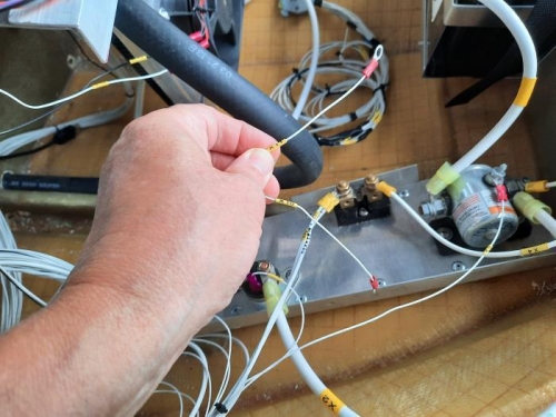

During this time I did some research on how the Shunt works and finally figured out how the high and low amps wires going to the Dynon EMS module were to be connected at the Shunt.
D-sub J7 with crimped pins
D-sub J4 partly switched from soldered to crimped pins
Shunt hi/lo amps wires to EMS
