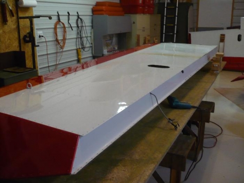

Brief Description:  Remove LE and top skin from right wing
jdupg11 to 25 .jpg's record the progress.
Removed left flap.
Removed fuel tank, need to touch up the inlet inside, deburr
Removed right leading edge skin

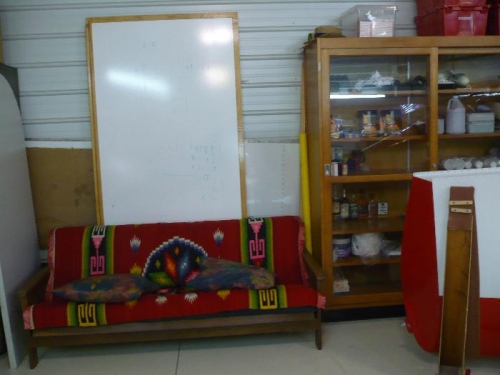

Removed right top skin, Stored it against the wall.

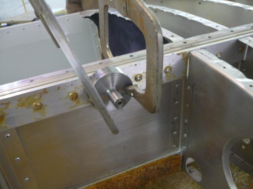

Removed heads from all upper spar rivets from 1680 inboard. The drill fixture helped hit center and control depth of cut.
Knocked heads off with chissel. Need to get a 5/32 drift to puch the rivets out. the 1/8 just causes it to swell. Need to clamp the layers also, just using a bucking bar might not be enough.
