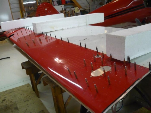

Brief Description:  Remove solid rivets from right wing
Ground down punch for use in rivet tool to punch out the rivets. It didn't work to well.

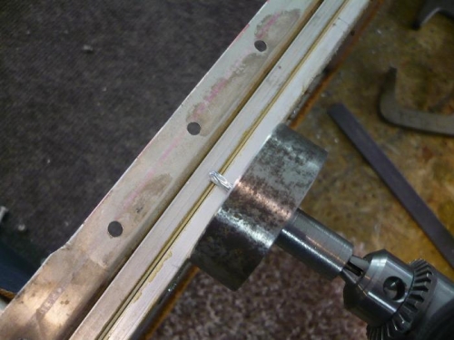

Drilled #30 just through the web and used a 3/16 pin punch and hammer with Bob holding the bucking bar to drive the rivets out. This worked best on the AN6 rivets, center punch, drill to depth with #30, cold chisel the heads off, hammer 3/16 pin punch with bucking bar backup.

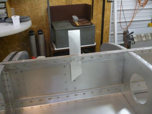

Cut the spar cap angle at 1680 from inboard end.
Set right wing aside and put left wing up on table.
Removed light lens, drilled out bottom leading edge skin and have it ready to flip.
Set drill depth just through web
Split spar cap angle at 1680
Left wing ready to flip
