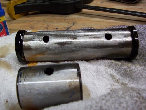

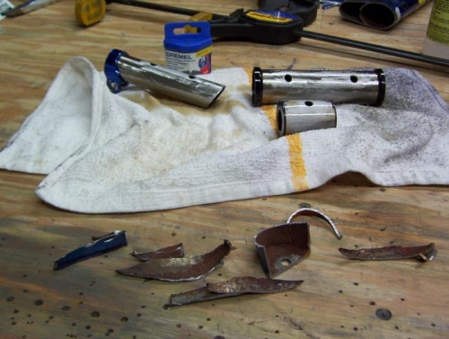

Clean up cutoff parts

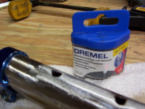

dUsed the sawsall and some Dremmel fiber reinforced cutoff wheels, what a difference that makes, to seperate the rest of the material from the parts.
Used 3" 36 grit sanding disk in 6" air grinder to clean up the welds back to the original surface.
SeatPost, SteeringHead & Pivot
Fiber Reinforced Cutoff Wheels
Oiled so they won't rust
