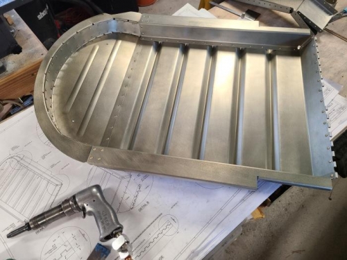

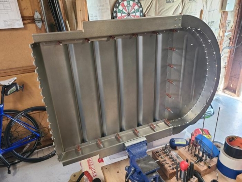

Brief Description:  Riveting Rear Seat Back and Floors
Today I completed riveting the rear seatback. I used a combination of the rivet squeezer for the rivets I could reach and the rivet gun and bucking bar for the ones I couldn't reach with the squeezer.

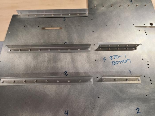

Then I moved on to riveting the nutplates and stiffeners to the floors. I back riveted the stiffeners and used the bucking bar and rivet gun for the AN470 rivets. I also riveted the nutplates on the baggage floor.
