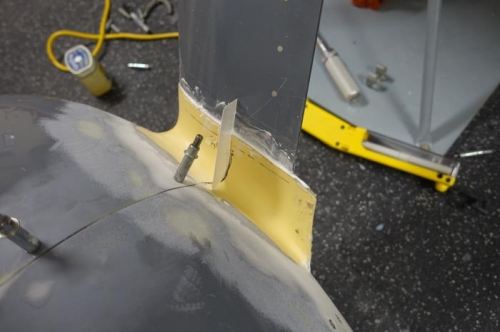

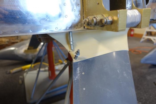

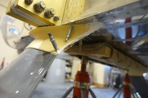

Worked on the main gear intersection fairings. Sanded the slurry mix on the top surface of the upper fairings. Trimmed the trailing edge of the upper fairing and drilled for a single attachment screw to secure the trailing edge. This is a modification from using safety wire called out on the plans. Applied a coat of slurry to level off and clean up the trailing edge.
Applied a mixture of cabo and micro to the lower intersection fairing and the gear fairing.
