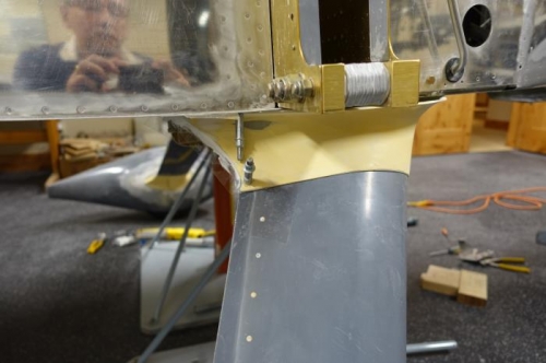

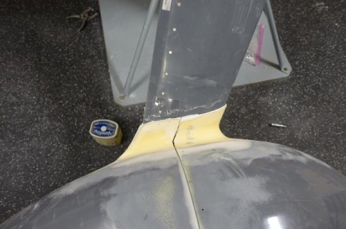

Manual Reference:  48-11, 12 & 20
Brief Description:  Wheel Pants
Continued working on the main gear intersection fairings. Shaped them further and continued with another application of flox/micro.

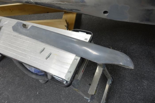

Started on the nose gear fairing. It took some time to successfully mark and trim the various cut outs all along the fairing. The plans are pretty specific with dimensions etc. However, typical of many of the supplied fiberglass parts, they don't correlate with the drawings. Interpolation is practiced skill.
