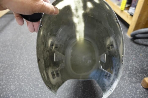

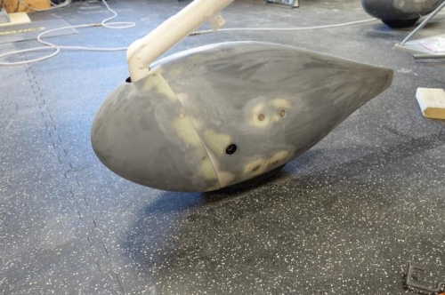

I sanded a small portion of the nose wheel and countersunk the main attach screw holes. I cut the two tow bar access holes. I then mounted the assembly to the airplane and made few minor fit tweeks.
I removed the upper main gear intersection fairings. I sanded the slurry fill around the gear leg fairing. I then added additional slurry to the area of the fairings I fiberglassed yesterday. I still need to trim the trailing edges but these pieces, to include the nose gear fairing are pretty much done and ready for priming.
