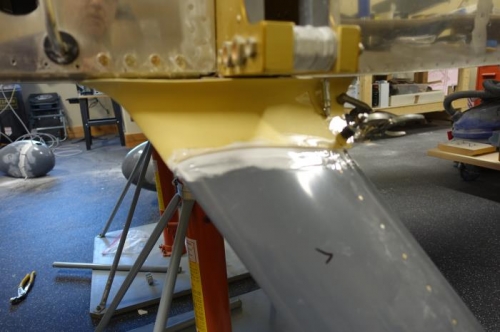

After cleaning up the upper main gear intersection fairings I applied a slurry mix to the inside of the fairings around the gear leg fairing to achieve a molded fit.

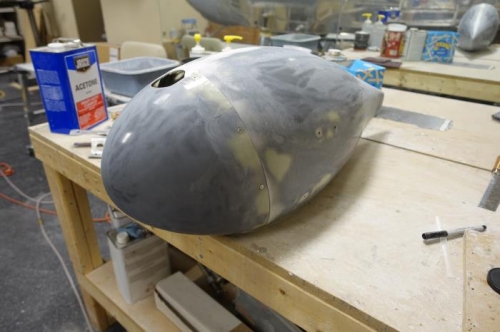

I went back to working on the nose gear fairing. I sanded down all the slurry and cleaned up the gap between the front and rear halves. I final drilled the attach brackets and installed the eight number 8 nutplates. I then drilled out and installed the eight number 6 nutplates attaching the two pieces together.
