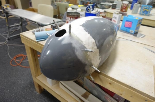

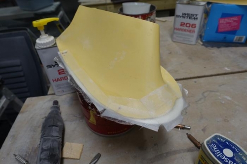

I removed, cleaned and sanded the upper main intersection fairings slurry fill. Flowing, I applied a layer of 6 oz cloth around select perimeter of the fairings for additional support.
I sanded the transition between the front and rear halves of the nose gear pant. Addtionally, and sanded the seam along the top and bottom of the rear halve. I then applied slurry filler along the halves intersection and all along the searm of the rear pant.
