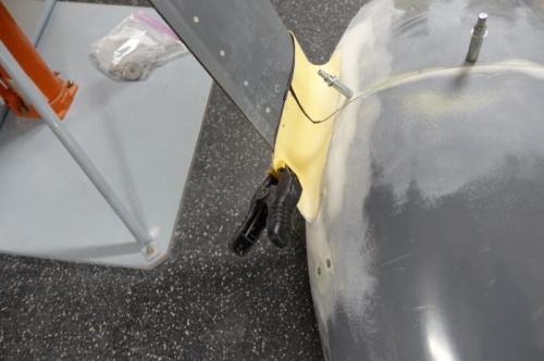

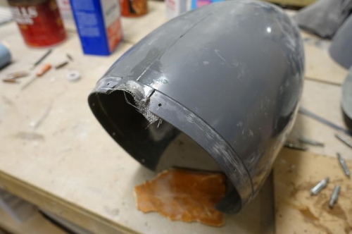

I fiberglassed the small filler plate to the nose wheel pant. I also added a little slurry to the mounting holes to further contour.

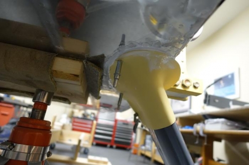

I applied a slurry mix to the top main gear intersection fairing to get a tight fit against the fuselage. I also glued with cabo the trailing edge of the bottom main gear intersection fairings.
