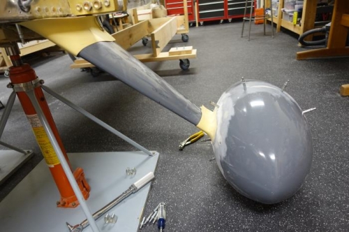

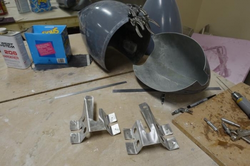

Date:  11-24-2020
Number of Hours:  2.60
Manual Reference:  48-19
Brief Description:  Wheel Pants
I removed the nose wheel pant's attach brackets and cleaned up the mounting pads and the two brackets. I test mounted the entire pant in order to measure and trim the upper filler piece directly behind the gear leg. I epoxied the piece to the rear pant. I'll go back and fiberglass the piece permantently in place after it dries. I mounted the main wheel pants in preparation for further intersection work.
