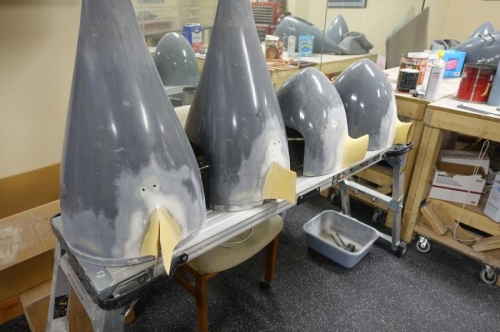

Brief Description:  Wheel Pants
I removed the nose wheel brackets from the flox standoff fill. I then sanded down the excess flox and contoured the fill. Lastly, I applied a light filler coat of micro, a layer of 6 oz cloth and the brackets over the standoffs.
I broke down and sanded the micro filler around the main pant intersection fairings.
