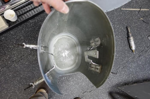

Brief Description:  Nose Wheel Pant
I removed the nose pant after the bracket flox had plenty of time to dry. I was concerned that I may not have had a full fill of flox after wrestling with installing the bracket inside the pant. Sure enough, there was enough flox to establish the standoff but there were voids. So, I went ahead and mixed another batch of flox, filled the voids and reinstalled the brackets. Now I wait again.
