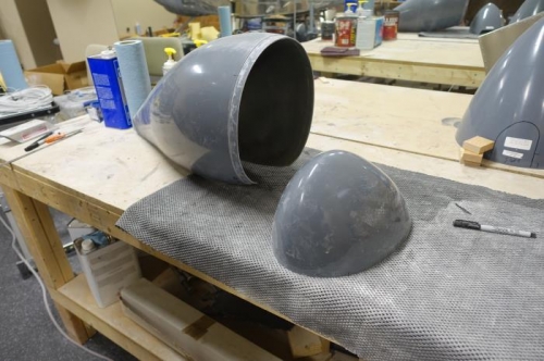

Lots of work on the wheel pants and gear leg fairing. First, worked on the right pants mounting pads. Cleaned the excess flox and applied an additional coat of cabo covered by a layer of 9 oz cloth.

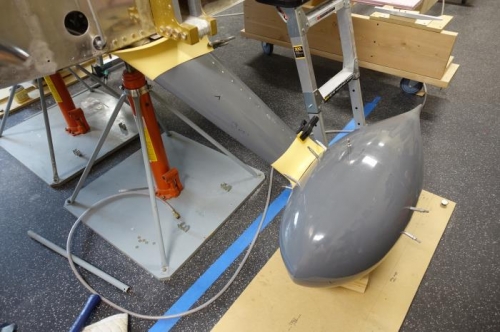

Fabricated the left and right gear leg fairings. Installed the left fairing along wiith the top and bottom intersection fairings.
Began work on the nose gear wheel pant.
