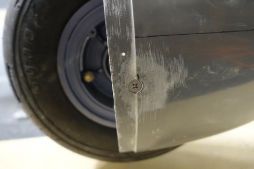

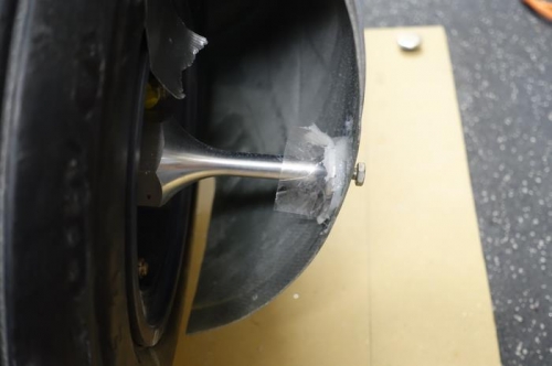

Got the right pant in place, drilled the four attach holes and applied the flox filler. Riveted the four nutplates to the left pant and countersunk the four inboard screw holes and single outboard hole.

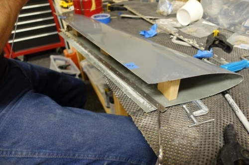

I'm going to include the gear leg fairings to this category. Began fabrication of the main fairings to include trimming to shape and installing the attach piano hinge.
