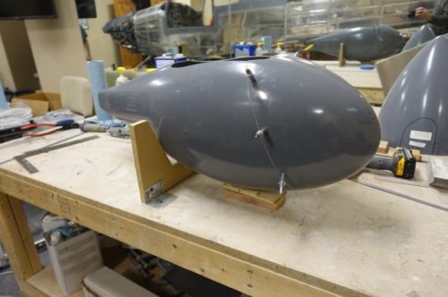

Lots more wheel pants work.

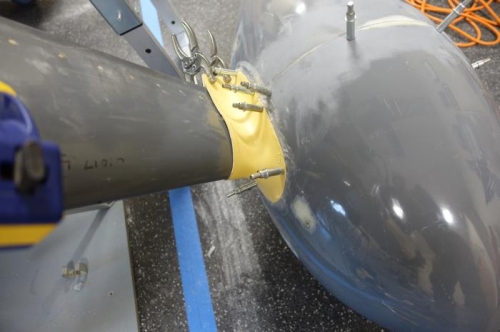

Applied a flox mix to the main mounting point on the right pant.
Modified the right lower intersection fairing and after a lot of trimming and fitting, glued the fairing to the front and back pant with cabo.
Continued fabrication of the nosewheel pant. Deburred and cleaned the mounting brackets. Fabricated the two aluminum standoffs (Van's should manufacture these pieces....this is not my RV-6 project from 1988). Established alignment of the pant assembly.
