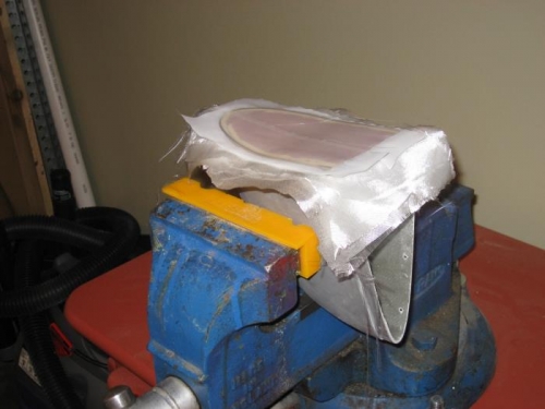

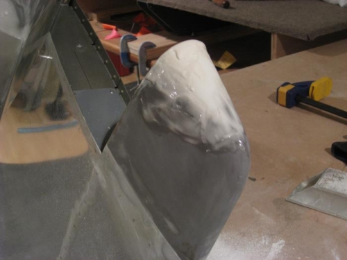

Sanded the horizontal stabilizer closeouts in preparation for fiberglass. Applied three layers of 2 ounce cloth on the closeouts. Sanded the vertical stabilizer tip to match the contour of the rudder tip. Applied a bit more micro to dill a couple of low spots.

Horizontal stabilizer tip closeout
Vertical stab tip with a second thin coat of micro
