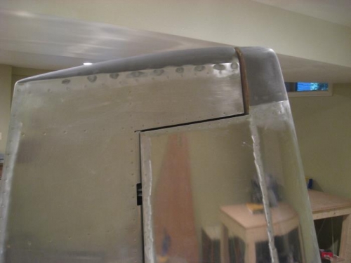

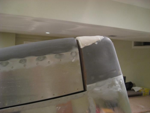

Mounted the rudder and verified proper deflection. The rudder tip is slightly higher thatn the vertical stabilizer tip. I put down a layer of micro on the vertical stab tip to match the rudder.

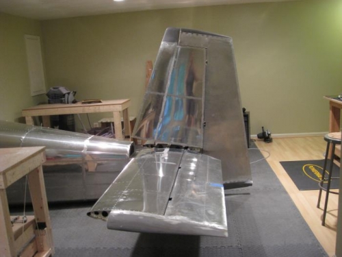

Began installation of the horizontal stabilizer tips. The tips appear t be poorly matched. I may be able to heat up the tips and make sufficient adjustments.
Rudder and vertical stab with slightly offset tips
Layer of micro
Layer of micro
Full empennage
Full empennage
