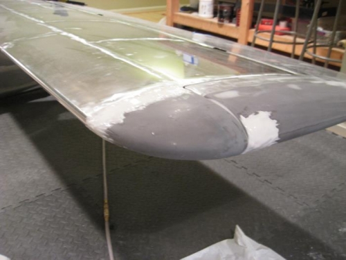

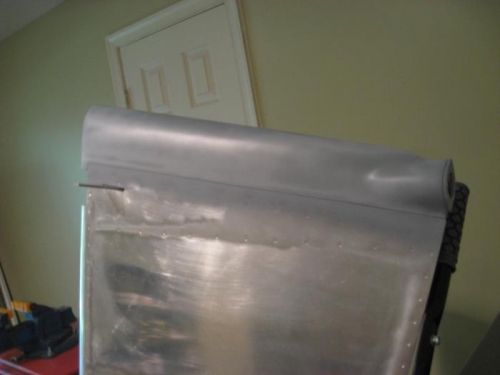

Finished sanding the horizontal stabilizer tips. Countersunk the tips and dimpled the stabilizer for the tips. Riveted the tips to the stabilizer. Applied micro to the strips as well as the elevator tips in order to match the contour of the HS tips. Primed the vertical stabilizer and rudder fiberglass tips. There are a few pin holes taht will have to be filled with glazzing putty.
Horizontal stabilizer and elevator tips

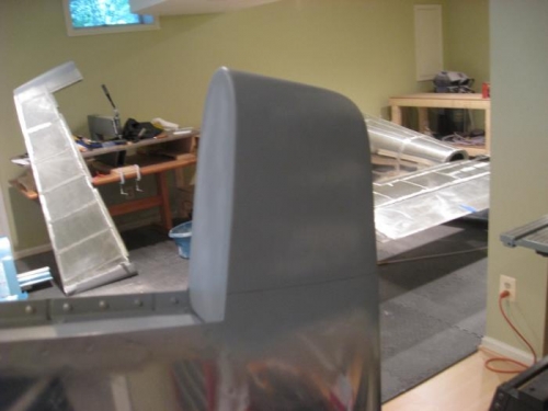

Primed vertical stab
