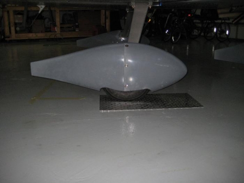

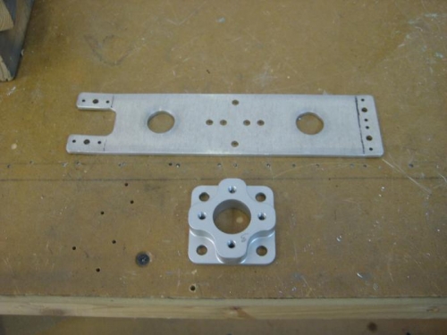

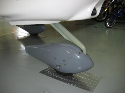

I decieded that 4 knots is 4 knots and I wanted them so I revisited the wheel pants. My Issues were that I couldn't service the brakes without removing the wheel and axle because the bracket blocked the acess. I also wanted more clearence for grass landings. I visited some friends RV12's to see how Vans handled the pants. They bolt a bracket to the axle and the wheel pant bracket bolts to it. Remove a couple of bolts and you have full acess to the brakes. My friend loaned me the parts to see if I could adapt them to my S19. They fit perfect so he told me to use them and he would order more since he didn't need them yet. I also trimmed the wheel opening a little more for more clearence. While I was there he said try this nose strut fairing to see how it fits. It fits like it was made for it, All I have to do is trim an inch off of the end. I'll be using it also.
