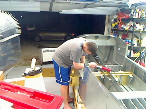

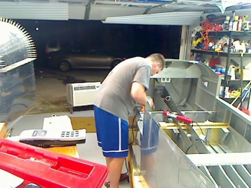

But in the course of the day, I was talking to a repeat builder and close friend Dave Forster. I told him that I found the AN-3 HW had been torqued to 85 inches in the QB factory. I called Vans and they suggested backing the nuts off to neutral and then retorquing to 25 inches.
Dave was concerned that the bolts might have stretched or the hw was damaged. Ultimately he talked me into changing it out and I respect his opinion. So today I got started replacing the AN-3 HW on the left main. The old stuff is going to the trash can.
