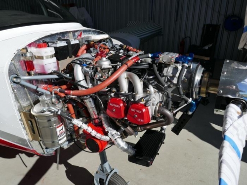

Brief Description:  Engine inspection.
BDH very kindly inspected the engine prior to final inspection.
There was a few items which we had to address, namely, the alternator belt had stretched, therefore it needed tightening, inspect the Mag. plug and safety wire, trim the oil reservoir over flow pipe. top up the coolant and tape the air filter.
BDH's help is greatly appreciated, thank you.
Rotax 914 UL.
Rotax 914 UL.

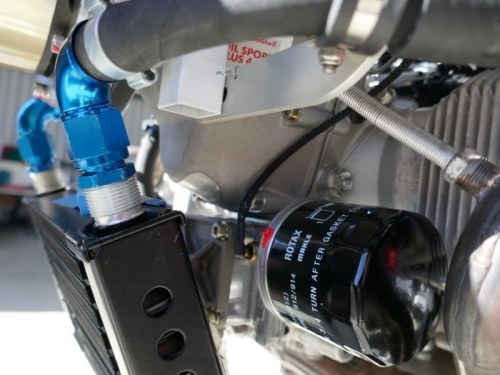

Magnetic plug satety wired.

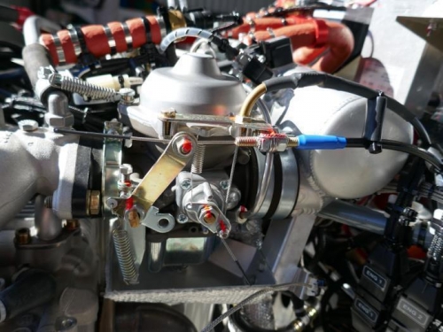

Witness marked.
Witness marked.
