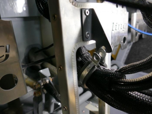

I have been trying to figure out how I was going to secure an electrical loom under the instrument panel.
I decided a P-Clamp would be the best option.

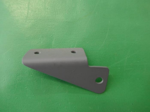

I made a bracket to rivet to the "Front rib mounting channel ", which allows a P-Clamp to be installed to secure the loom.
Loom bracket.
Loom bracket.

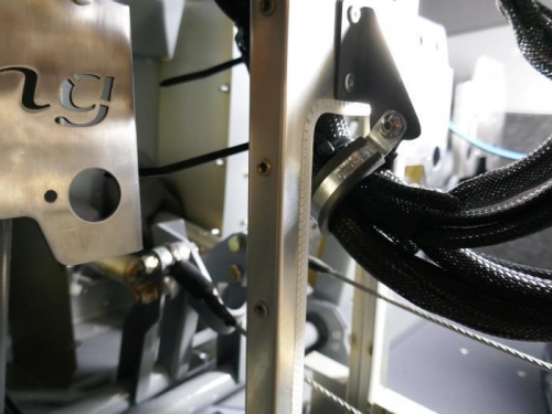

Loom secured.
Loom secured.
