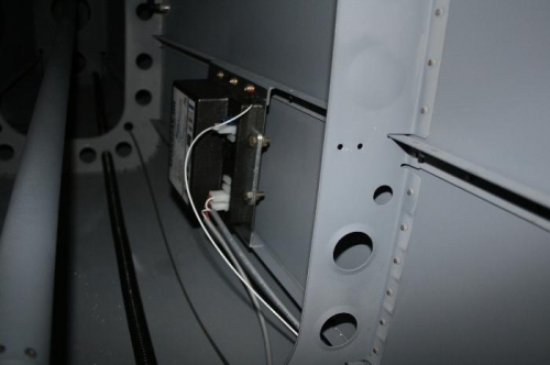

Brief Description:  Wire routing #3 (strobe wiring)
Somehow I let myself get confused on the wiring sizing for the taxi and landing lights. I used 16 and per Duckworks they recommend 14awg. Hint: if you are unsure of a wire size check with the component manufacturer, they almost always have a recommendation. 16 might have worked, but I feel better being conservative. So I removed the 16 and put 14awg back in my wings - took just a couple of minutes since I don't have connects on yet.
Wired up the Strobe power supply w/16awg from the power supply to the switch and the switch to the c/b. I installed the power and ground to the molex connector that mates to the power supply. As part of that I ran the ground locally to the bracket that holds the power supply.
The white wires are the ones installed tonight.
