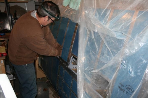

Finished up the pitot tube heat wiring within the wing. I connect the ground wire to a ring terminal and screwed it to the wing rib near by and ran the 14awg wire from the root out to the positive wire and connected molex single wire connectors. I had some trouble figuring out how to use the single wire molex connectors and destroyed one in the process - collateral damage!
I still need to put a connect on the wing root end of the wire for where it hooks into the fuse, but I will likely combine the nav and landing lights with the pitot heat into a single molex 3 pin connector.

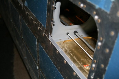

Attaching the local ground on the pitot heat to one of the ribs.

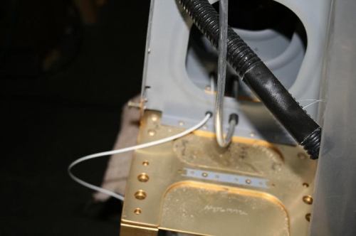

The wire visible next to the air line.
