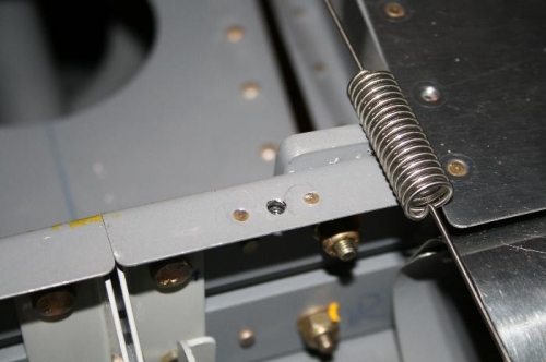

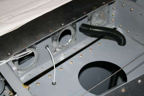

Anyway, back to building. Cold start this morning, literally, with temps around 15F. I managed to drill the grommets holes in the left horizontal stab (HS) end rib and aft deck for the tail light. Installed a nutplate in the top flange of the HS spar to mount a phenolic or teflon block to hold the ELT antenna still under the empennage failing (i'm trying to think ahead).
Routed the conduit through the left HS end rib. I then mounted and torqued all of the vertical stab bolts.

Large conduit the holds the elev trim and tail pos light wires - also pos lgt wire going back down
Nutplate for the future antenna retainer block - yet to fabricated
