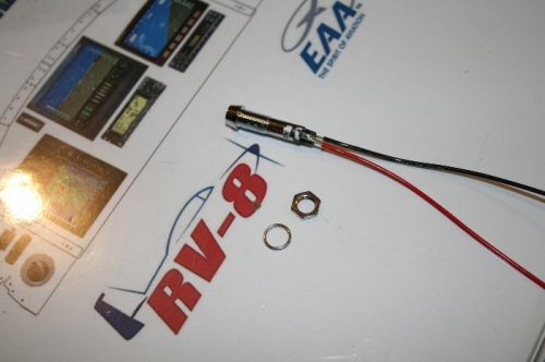

Since the regulator on the alternator is wired for an idiot light I thought I'd wire it up.
Sourced a 12v LED lamp with metal holder.
Soldered the wires to the lamp (a pain for some reason)

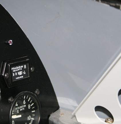

Drilled the hole
Mounted above my hobbs on the right hand side of my panel
Wired it to the intercom c/b (1amp) and universal ground cluster.
