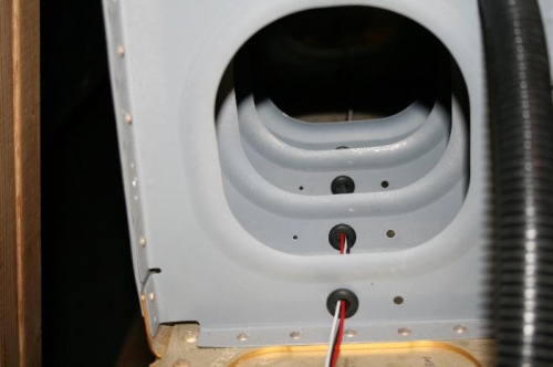

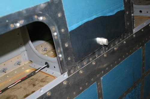

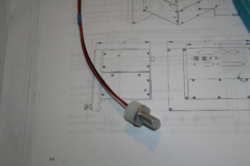

-Installed the OAT probe this morning into the right wing
-Used the existing tooling holes and rubber grommets for the wire run.
-Located it between the inspection covers on the bottom of the right wing for easy access and servicability. Drilled the hole
-Spliced 20awg wire (white, black, red) to the pig tail on the probe and ran them through the ribs.
I'll connect it when the wings on.
The outside air temperature probe
Wire run in right wing
wire run and probe
wire run and probe
