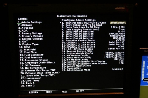

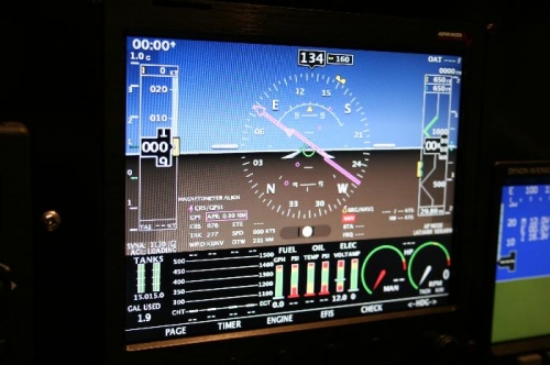

I again attempted to get the 696 GPS to display on the EFIS and although the book said to select NMEA/AVTN for the serial port, I put in NMEA 4800 and it came on - ta da!

Here's the admin page where you program the serial ports for the various inputs
Magenta needle displaying GPS - success!
