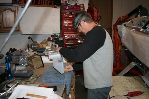

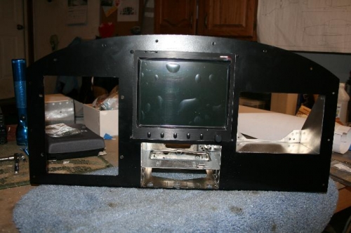

My AFS 3500EE finally came in yesterday so I could fit it in the panel. First I had to sand the opening an produce a tighter radius in the corners to match the AFS. Then I layed out and drilled the 4 mounting screw holes. Next I sanded the panel to allow another coat of paint after the sanding and drilling.
Sanding the opening for the AFS 3500
Here it is temporarily in the panel.
