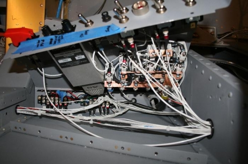

Brief Description:  c/b panel finished and started on sub panels
Got the c/b panel done. I got all the switches (except mags) wired and all the wires tucked away. I still need to secure the various bundles a little better, but I was more or less testing how the encloser fit with everything in place. I will probably line the fuselage side wall with material to prevent any chaffs and the same for the bus bars (incase a wire gets in the wrong place and droops down onto the c/bs). There is a bit of a delicate balance between having enough of a service loop to get the panel open and not having wires too loose that they get against something bad. If I had to do it again I would put the intercom in the panel and I would have spaced the c/b further apart vertically and horizontally.

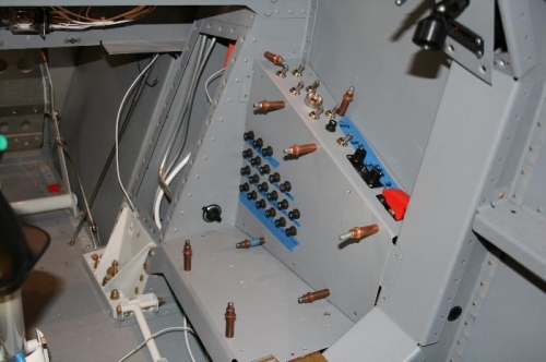

I then put the switches and the air vent into the left subpanel.
Everything in place under the c/b switch panel.

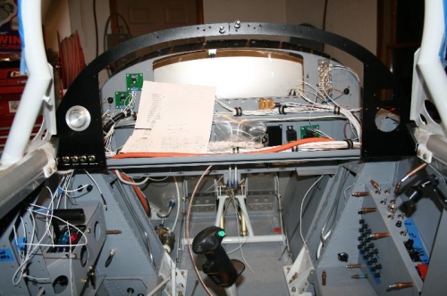

Here it is closed up.
